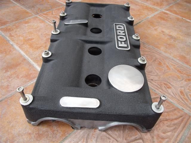

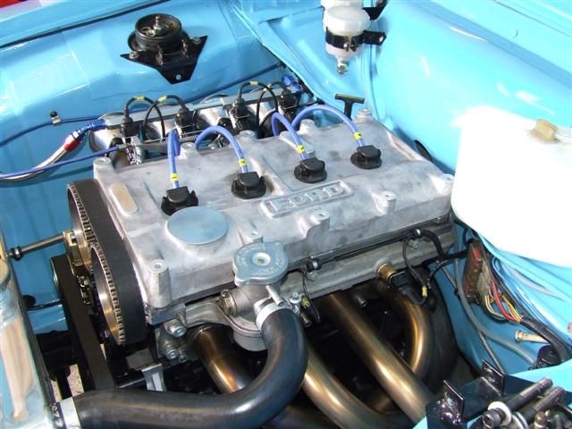

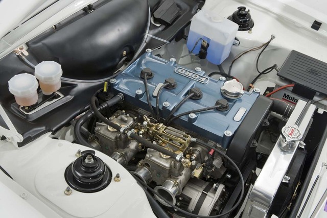

roumi Posted February 15, 2013 Report Share Posted February 15, 2013 Avec le cache culbu imitation BDA, c'est dur ensuite pour un novice de voir la différence. Quote Link to comment Share on other sites More sharing options...
Alex Posted February 15, 2013 Report Share Posted February 15, 2013 et c'est plutôt pas moche : Quote Link to comment Share on other sites More sharing options...
Sourire Posted February 15, 2013 Author Report Share Posted February 15, 2013 Moi j'aime beaucoup ;) Quote Link to comment Share on other sites More sharing options...
Alex Posted February 15, 2013 Report Share Posted February 15, 2013 moi aussi, comme ça c'est chouette, il n'y a pas un bazar de câbles et tuyaux genre chaudière à condensation ou dci. Quote Link to comment Share on other sites More sharing options...

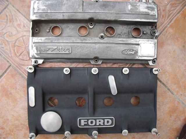

Sourire Posted February 15, 2013 Author Report Share Posted February 15, 2013 Quote Link to comment Share on other sites More sharing options...
Sourire Posted February 15, 2013 Author Report Share Posted February 15, 2013 Au vu des fixations, il faut repercer j'ai l'impression ? Quote Link to comment Share on other sites More sharing options...

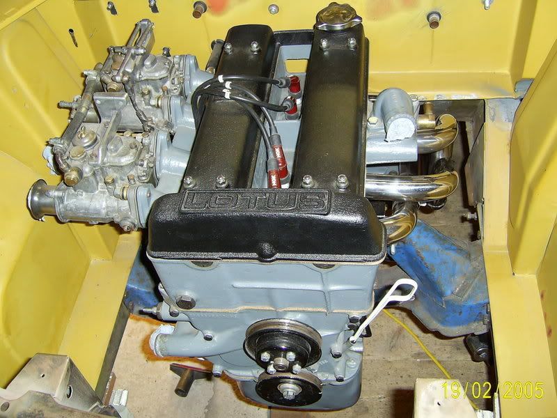

hotrod66 Posted February 15, 2013 Report Share Posted February 15, 2013 je préfèrerai un cache lotus sur le zetec (forcement... sur une europa!) et moins compliqué à "bricoler" (se le faire soi-même) Quote Link to comment Share on other sites More sharing options...
