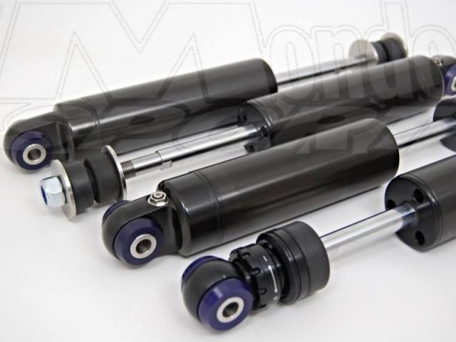

Sinon chez mondosport:
New Mondosport Quantum Historic App K FIA Dampers for the Classic Mini. Years of developement of the impressive Miglia style damper but now in steel bodies and rubber mounted to comply with regulation
plus d'infos ici: leigh@geralddale.co.uk
