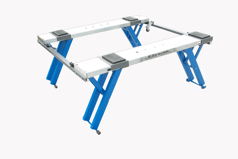

Alex Posted October 23, 2008 Report Posted October 23, 2008 L'Easycarlift : http://www.ezcarlift.com $2000 (1562€) gros avantage, on peut travailler en dessous, il ne gêne pas ! http://www.ezcarlift.com/PDFs/Brochure-Spec.pdf Quote
