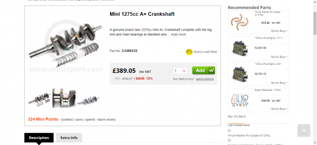

Jef Posted May 19, 2019 Author Report Posted May 19, 2019 Non je ne pense pas, voila celui que j'ai commandé ... Quote

PiOnPiOn Posted May 22, 2019 Report Posted May 22, 2019 la description donne: Easily recognisable with the letters and numbers CAM 6232 in the forging, this Mini A+ crankshaft has main bearing sizes 50.813-50.825mm and big end sizes 44.460-44.473mm. tu as mi les calles latérales aussi? bien souvent c'est elles qui coincent Quote

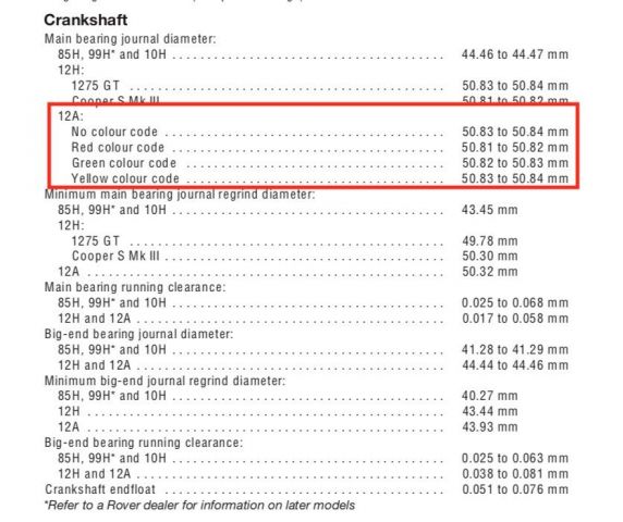

PiOnPiOn Posted May 22, 2019 Report Posted May 22, 2019 donc voilà ce que j'ai trouvé: voilà pour les couleurs ce que dit le Haynes: Quote
PiOnPiOn Posted May 22, 2019 Report Posted May 22, 2019 je t'envoi le haynes en MP, tu as les jeux et tout et tout Quote
